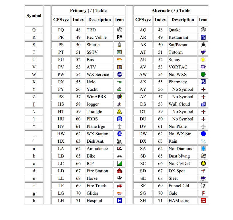

Another category is to expand the RAIN symbol to make it kinda
like lots of angled dots coming from the sky, but with an open
center so that we can use overlays for a number of common
PRECIPITATIONS.  The consolidations would be:
"\`" (existing Rain) would be the symbol with no overlay
"R`" (an R overlay) would mean Rain
"F`" (an F overlay) would mean Freezing Rain  was \F
"H`" (an H overlay) would mean Hail           was\:
"D`" (an D overlay) would mean Drizzle        was \D
"E`" (an E overlay) would mean slEEt          was \e
"S`" (an S overlay) would mean Snow           was \*
Etc. and other particulates coming from the sky
Next, I propose expanding the existing RAIN SHOWER "\I" symbol
to look like some kind of cloud symbol with specks in it that
can be overlayed. (It needs to look different from the next
CLOUD symbol). It can then consolidate these symbols:
"RI" (an R overlay) would mean Rain Shower
"SI" (an S overlay) would mean Snow shower    was \G
"LI" (an L overlay) would mean Lightening     was \J
Etc. and other things related to clouds
Next, I propose expanding the existing CLOUD symbol to allow
definition of any number of different types of cloud.  This
needs to also look like a cloud but a different shape and allow
for overlays  (Maybe this cloud is clear):
"\(" is the existing cloud symbol (would have no overlay)
"P(" with P overlay would mean partly cloudy        was \p
"W(" with W overlay would be a wall cloud           was \[
"F(" would be Funnel cloud, but the original "\f" will also be
retained for now
All of these initiative will free up a lot of overlayable symbol
GROUPS each of which can suport up to 36 different overlays in
each group for the future:
#H for 36 new Hazards (was only Hail)
#[ for 36 new human symbols (was only Wall Cloud)
#\ for 36 new GPS or navigation equipment
#B TBD. \B was only blowing snow         now is BE
#b TBD. \b was only blowing dust/sand    now is DE
#{ TBD. \{ was only fog                  now is FE
#* TBD. \* was snow only                 now is S`
#: TBD. \: was hail only                 now is H`
#D TBD. \D was drizzle only              now is D`
#F TBD. \F was freezing rain only        now is F`
#e TBD. \e was sleet only                now is E`
#G TBD. \G was only Snow shower          now is SI
#J TBD. \J was only Lightening           now is LI
#p TBD. \p was only partly cloudy        now is P(
Of course future code can fully draw each of these overlays as
distinct special symbols in any way they want.
