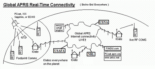

Figure 5.The APRS Satellite Operations Concept consists of mobiles, portables, ground stations and the Internet.
SATgate Operations:  Normally for mobile position reporting and tracking, the APRS uplink objective is to get the packet out and received somewhere else via the global APRS Internet System (APRS-IS).  In this case, mobiles concentrate on being heard, and permanent satellite gateways focus on receiving the downlink and feeding it into the APRS-IS.  To date, all APRS SATgates have only been monitoring the 145.825 APRS and 145.800 ARISS channels for APRS and ARISS packet activity.  Since there has been little 9600 baud APRS satellite activity to date, it will take a while for stations to gear up for this new frequency and 9600 baud operation. We hope volunteers will surface with permanent SATgates.  Until we have more SATgates, do not expect to see yourself on FINDU.COM.  Enjoy ham radio, make a Live contact instead!
