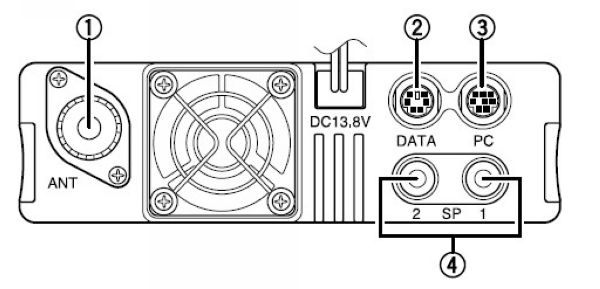

соединяем PC на приборе с портом COM1, COM2.

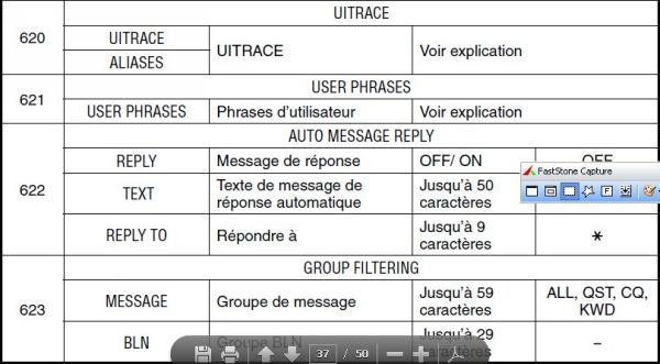

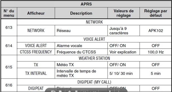

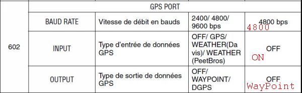

| Position menu | PM 1 - Mobile | PM 2 - Home | PM 3 - WX | PM 4 - Digi | |
| APRS / NAVITRA Blok -1 |

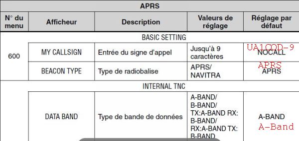

600 Beacon Type | APRS | APRS | APRS | APRS |
| 600 My Callsign | UA1COD-9 | UA1COD-1 | UA1COD-13 | UA1COD-3 | |

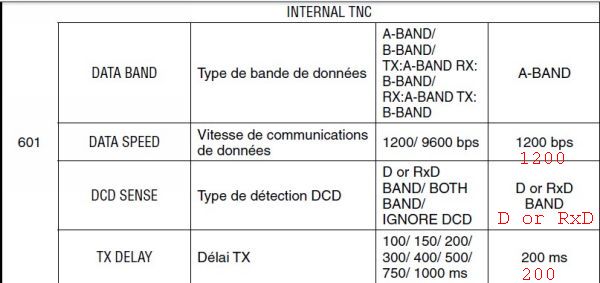

| 601 Internal TNC Data Band | B | B | B | B | |
| 601 Internal TNC Data Speed | 1200 | 1200 | 1200 | 1200 | |
| 601 Internal TNC Data Sense | D or RxD Band | D or RxD Band | D or RxD Band | D or RxD Band | |
| 601 Internal TNC Tx Delay [ms] | 200 | 200 | 200 | 200 | |
| 602 GPS Baud Rate [bps] | 4800 | 2400 | |||
| 602 GPS Input | GPS | Off | WX (Peet Bros.) | Off | |

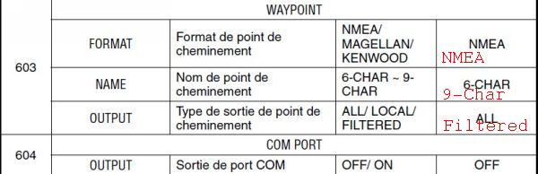

| 602 GPS Output | WAYPOINT | ||||
| 603 Waypoint Format | NMEA | ||||
| 603 Waypoint Name | 9-character | ||||
| 603 Waypoint Output | Local | ||||
| 604 COM Port (Panel) Output | Off | On | Off | ||

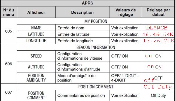

| 606 Beacon Information Speed | On | Off | Off | Off | |
| 606 Beacon Information Altitude | On | Off | Off | Off | |
| 606 Beacon Information Position Ambiguity | Off | Off | Off | Off | |
| 607 Position Comment | Enroute | Off Duty | In Service | In Service | |

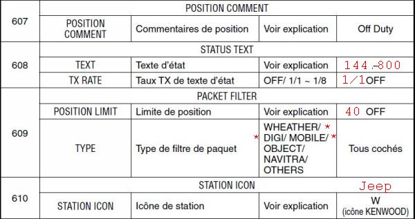

| APRS / NAVITRA Blok - 2 |
605 My Position | ||||
| 608 Status Text | Wn,SPn Opole | ||||
| APRS / NAVITRA Blok -3 |
609 Packet Filter Position Limit [mi | km | knots] |
100 | Off | 300 | Off |
| 609 Packet Filter Type Weather | On | On | On | On | |
| 609 Packet Filter Type Digi | On | On | On | On | |
| 609 Packet Filter Type Mobile | On | On | On | On | |
| 609 Packet Filter Type Object | On | On | On | On | |
| 609 Packet Filter Type NAVITRA | On | On | On | On | |
| 609 Packet Filter Type Others | On | On | On | On | |

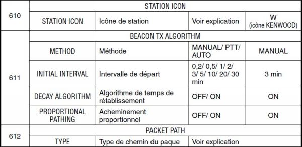

| 610 Station Icon (Tbl: Table, Sym: Symbol) |
Car | KENWOOD | WX | Others Symbol # Table S |
| 611 Beacon Tx Algorithm Method | Auto | Auto | Auto | Auto | |
| 611 Beacon Tx Algorithm Inital Interval [min] | 1 | 20 | 5 | 10 | |
| 611 Beacon Tx Algorithm Decay Algorithm | On | On | Off | Off | |
| 611 Beacon Tx Algorithm Proportional Pathing | On | Off | Off | On | |
| 612 Packet Path Type (New-N:New-N Paradigm, RE:RELAY Paradigm, S/ S/R:State/ Section/ Region |
New-N | New-N | New-N | New-N lub State/ Section/ Region |
| 612 Packet Path WIDE1-1 | On | Off | Off | Off | |
| 612 Packet Path Relay | --- | --- | --- | --- | |
| 612 Packet Path ABBR | --- | --- | --- | SP | |
| 612 Packet Path Total Hops | 3 | 2 | 2 | 2 | |
| 613 NetWork | APRS | APRS | APRS | APRS | |
| NetWork ALTNET | --- | --- | --- | --- | |
| 614 Voice Alert | On | Off | Off | Off lub RX Only nigdy On |
| 614 CTCSS Frequency [Hz] | 136.5 | 136.5 | 136.5 | 136.5 | |
| APRS / NAVITRA Blok - 4 |

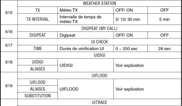

615 WX Station WX Station Tx | Off | Off | On | Off |
| 615 WX Station Tx WX Interval [min] | 5 | ||||
| 616 DIGIPEAT (My Callsign) | On | On | On | On | |
| 617 UICHECK | 30 | 30 | 30 | 30 | |
| 618 UIDIGI | Off | Off | Off | Off | |
| 618 UIDIGI Aliases | Refer UIDIGI Aliases | ||||
| 619 UIFLOOD | Off | Off | Off | SP | |
| 619 UIFLOOD Substitution | ID | ID | ID | FIRST | |
| 620 UITRACE | On | On | On | On | |
| 620 UITRACE Alias | TEMP | TEMP | TEMP | WIDE | |
| 622 Auto Message Reply | Off | Off | Off | ||
| 622 Auto Message Reply To | * | * | * | ||
| APRS / NAVITRA Blok - 5 |

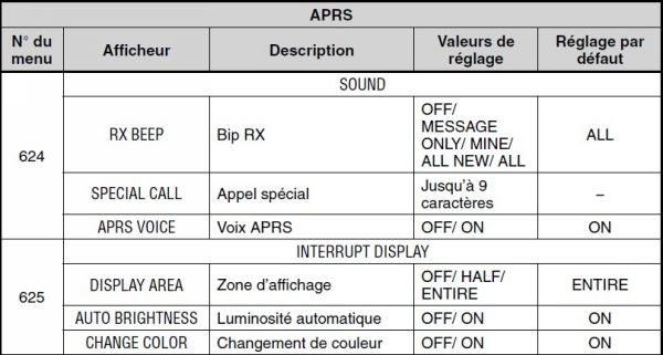

624 Sound Rx Beep | AllNew | Message Only | Message Only | |
| 624 Sound Special Call | |||||
| 624 Sound APRS Voice | On | On | On | ||
| 625 Interrupt Display Display Area | Entire | Entire | Entire | Entire | |
| 625 Interrupt Display Automatic Brightness | On | On | On | ||
| 625 Change Color | On | On | On | On | |
| APRS / NAVITRA Blok - 6 |

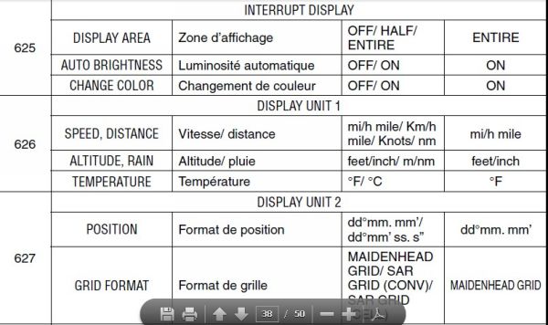

626 Display Units Speed, Distance | km/h, km | km/h, km | km/h, km | km/h, km |
| 626 Display Units Altitude, Rain | m, mm | m, mm | m, mm | m, mm | |
| 626 Display Units Temperature | degree C | degree C | degree C | degree C | |
| 627 Display Units Grid Format | Maidenhead | Maidenhead | Maidenhead | Maidenhead | |
| 627 Display Units Position | dd mm.mm | dd mm.mm | dd mm.mm | dd mm.mm | |

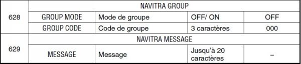

| 628 NAVITRA Group Mode | --- | --- | --- | --- | |
| 628 NAVITRA Group Mode Group Code | --- | --- | --- | --- | |
